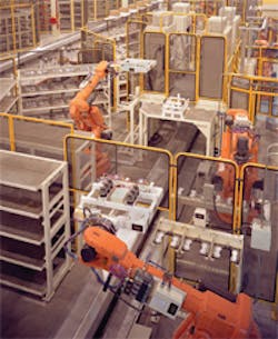

At the Nemak Windsor Aluminum Plant (WAP) in Ontario, core machines blow sand premixed with resin into tool cavities to create the individual core sections. Each core section is robotically assembled to form the complete core package, which then is ready for pouring.
The production lines use foundry-specific robots that are sealed from moisture and dust and are able to sustain consistently high temperatures. ABB Robotics (www.abb.com) has been working with Nemak on planning, support and strategies for robotic handling and assembly of sand packages since1998. It has set up the robotic lines for several Nemak facilities worldwide. Gustavo Sepulveda, ABB’s general manager for Robotics at Nemak Mexico notes that Nemak typically uses 6-axis robots with a 200-kg load capacity. “Each facility is different,” he says. “On average, every line has between 12 and 15 robots. Some of them may be handing extra parts, or they have added additional operations beside the sand core assembly. The minimum number is typically 12,” he says.
Fanuc Robotics America Inc. (www.fanucrobotics.com) provided the robotic lines for WAP. John Utley, Fanuc, project manager explains that a series of core machines, each making a piece of what will be assembled into the final core mold, form the front of the lines. Each core machine has a robot installed in front of it. When the machine produces the sand core, the robot moves it to a table where a sub-assembly process is performed on each core.
“We can load them directly onto the main line where the cores would proceed through all subsequent steps. Or, if the line is blocked upstream for any reason, we can have the robots pick the set of cores and load those to the shelving system on the other side of the line. There are six sub-system cells set up along a main line assembly line — start to finish,” Utley details. “The package gets built up until there is a complete core package at the end of the line.”
Utley notes that the line is set up with both pedestal- and rack-mounted robots. The pedestal mounted robots handle the core machine unloading operations while the rack mount give a more vertical envelope for the buffer shelf positions needed on the other side.

“The robots do more than simply pick up sand cores and move them from ‘A’ to ‘B’. They must perform some quality inspections and operations to each core and then place each into what is known as a core package,” Stockwell says. “A core package can be likened to a puzzle where all the sections come together, yielding a finished mold. Once assembled, the core assembly receives the molten aluminum that will eventually become the end product.”
The main carrier starts as an empty conveyor collecting core sections one by one from each robotic station until a fully assembled sand core package is complete. At that point the mold moves to the casting area where molten aluminum is poured into its cavity. As the aluminum is solidifying, the mold is transferred into a Thermal Sand Removal (TSR) oven for sand breakdown and reclamation. The oven is set to a temperature just below that of the last stage of complete metal solidification, to deter incipient melting, but hot enough to allow sufficient thermal breakdown of the sand.

Six sub-system cells in the assembly line complete core packages. (Photo by courtesy of Nemak.)
