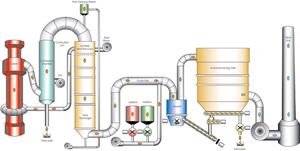

Kuttner’s solution uses Lhr’s patented baghouse technology (www.luehrfilter.de) and powdered activated carbon (PAC), a highly adsorbent form of carbon, to remove odors and emissions from liquids or gases. While PAC is a proven technology in mercury abatement, simply injecting carbon into the system is not enough to achieve a significant reduction in the volume of mercury emitted from the combustion process.
For PAC to be effective, an interaction must occur between the ionic mercury and activated carbon, and it must occur in a few precious seconds before the gases reach the bag filter. Kuttner uses a perforated conditioning drum filled with ceramic balls to provide the surface area for the reaction. As the drum rotates, it becomes a fluidized bed of material forcing a collision. The result is a significant amount of contact between the gases and the PAC, even in a short timeframe, and ultimately a higher degree of capture efficiency.
As an induced draft fan draws the gases to the baghouse, the Kuttner system uses a heat-recovery unit to cool the combustion gases down to a 280°F inlet baghouse temperature. The lower operating temperature and the ability to control the temperature of the gases are critical when attempting to remove mercury.
Traditionally, baghouse designs use water to cool the gas and control the temperature. In fact, competitive systems may use multiple spray towers within the overall process. To compensate for this water spray, these systems attempt to keep the temperatures elevated going into the house. Although this approach appears cost effective, over long periods of operation it has an adverse effect on the bags, and compromises the service life of the baghouse. In turn, this increases annual plant maintenance costs and capital expenses significantly
First, highly corrosive acid may form as condensation on the surface of the baghouse, compromising its structural integrity. It is not uncommon for the structure of a baghouse to become so unstable that they fall down on themselves. In addition, the higher temperatures within the baghouse cause the bags to become brittle and disintegrate. In extreme cases, a customer might need to replace the bags within six months; by contrast, bags used in the Kuttner process may last several years.
Luehr Filter bags are compact and packed to fit tightly inside the baghouse. More bags within the structure increases the surface area available for filtration.
Kuttner’s oil-based cooling system delivers precise temperature control. The temperature needs to be somewhere between the acidic dewpoint for sulphuric acid and the temperature at which mercury will react with the PAC. If the temperature is too low, precipitating acid will become a problem. If it’s not cool enough, the vapor pressure of mercury will not reach a point low enough to capture it.

Kuttner uses a perforated conditioning drum filled with ceramic balls to achieve a reaction between the ionic mercury and activated carbon, which collects mercury from the combustion gases before they reach the filter. As the drum rotates, it becomes a fluidized bed of material forcing a collision between the two reactants.
When designing an installation, Kuttner uses every possible advantage to generate better emissions capture, including the process of cleaning the filter bags.
A cleaning mechanism moves incrementally from row to row emitting a pulse of dry, compressed air that cleans the bags in small increments, without expanding the bag. The advantage is very little air volume goes offline from the process of capturing emissions at any given time, and a fine layer of filter cake is left on the bags. This approach maximizes the capabilities of the filter and minimizes the disruptions caused by offline cleaning.
The recycling nature of Kuttner’s baghouse also creates the potential for a high proportion of effluent dust recirculating in the system. This leads to increased mercury capture, but also significantly lowers overall operating costs. A higher ratio of recycling means less PAC needs to be purchased, and that there is less waste to be disposed.
