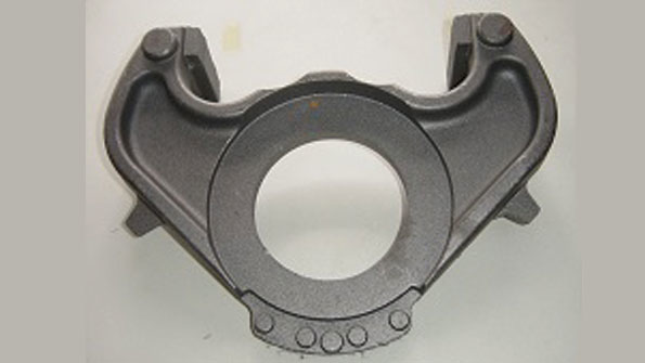

A cast ductile iron part for control arm. The foundry originally approached the feeding design for this casting by placing two symmetrical feeders, but that arrangement produced excessive porosity in the part, and no acceptable castings were produced with that arrangement.

Case study: Ductile iron control arm
Let’s consider the example of ductile iron control arm shown above. The foundry originally approached the feeding design for this iron casting by placing two symmetrical feeders. This was, perhaps, understandable as the two sections to which these feeders were attached are the heaviest sections of the casting.
During initial production of this casting, porosity occurred consistently at one feeder contact. The porosity does not always show at the same contact, but on all castings one contact showed porosity and the other did not.  No acceptable castings were produced with this pattern design.
Next, this casting was analyzed using the approach described previously to determine feeding requirements.  First, an unrigged simulation was performed.  Then, the simulation data was converted to Modulus data so that feeding calculations could be performed.  Figure 4 shows a plot of the areas of highest Modulus in the casting.  From this plot, the foundry engineer might be tempted to conclude that the original feeder design was correct, as there are two areas of high Modulus value in the casting and these are adjacent to the feeder contacts in the original design.
However, it is necessary to analyze this casting further to determine the Shrinkage Time, and from this the Transfer Modulus (MTR), in order to understand the location and size of the feeding zones in the casting.
Analysis of the iron characteristics for this casting indicated that the value of the Transfer Modulus is 0.645 cm.  Plotting this value in the casting indicates the single feed zone.
The areas of higher modulus are connected by a section of the casting in which the Modulus is above the value of MTR, thus allowing liquid transport for feeding throughout the casting.  This means that only a single feeder should be used on this casting.  With the two-feeder design, both feeders were connected to the same zone of the casting; when this is done, one feeder will pipe and the other feeder will not, resulting in porosity at the contact of the non-piping feeder.
It should be noted that the computer simulation in this case took 16 minutes to perform, and less than 5 minutes for the calculation of ST, MTR, and plot of simulated casting.  This means that it took just about 20 minutes of analysis to determine the correct feeder design.  Had this been done before the original pattern equipment was created, several months of time involved with production of defective castings would have been avoided.
After this information was presented to the foundry, the pattern was revised to reflect a single feeder.
Note that the feeder in this case is not connected to the casting at one of the areas of high Modulus.  This illustrates that with iron castings, the location of the feeder is not as critical as in steel castings, due to the expansion pressure that acts throughout the casting once precipitation of graphite begins.
In the final design, the contact area with a single feeder showed no porosity, and no porosity elsewhere in the casting.  Thus, a simple and quick analysis of the casting has produced the correct feeder design for making a sound casting.
