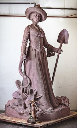

“I thought Bob’s pioneer woman image would be an excellent subject to render as a monumental sculpture,” Reilly reported. The finished work, titled “Not-So-Gentle Tamer”, will be installed at Arizona’s Prescott Valley Civic Center.
“So, with the painter’s close collaboration and the support of our local government officials, Bronzesmith artist Debbie Gessner began the task of re-creating the image in clay. This was a major undertaking as the final work would stand 10 ft tall.”

“We pour in air into ceramic investment casting shells mounted on a stainless steel frame,” Reilly continued. “These ceramic shells have been heated to 1,250°F (676°C) in our gas-fired kiln. Our pouring temperature is 2,150°F (1176°C) and it normally takes about six-and-a-half minutes to complete the entire pour. Our largest shell holds 150 lb (63 kg).
Large-scale works — like “Not-So-Gentle Tamer” — are cast in sections, cleaned and machined, and welded together to make the final sculpture,” Reilly said. “Smaller sculptures, such as miniatures of our piece, are cast as a single unit.”
