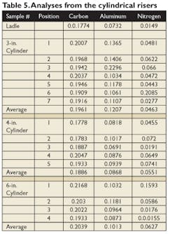

Effects of riser size  — During the course of the initial trials, relatively small, insertable sleeves were used, for speed and convenience. However, the effects of riser size were also debated. A smaller, sleeved riser would have a smaller modulus or volume-to-surface area ratio. This should mean that the sleeve could have a more significant effect because of the ratio of the surface area of the sleeve to the volume of the riser. However, it was also argued that larger risers would take longer to solidify with more time for aluminum or other contaminants to become dissolved.
Cylindrical sleeved risers with 3-, 4-, and 6-inch diameters were poured with the same low-carbon steel used in other testing. The LDASC sleeves all had the same EX formulation used in the other tests. As before, the sleeves were sectioned and subjected to spectrographic analysis at a number of locations. The results are shown in Table 5.
All of the risers seemed to show a slight increase in aluminum, and nitrogen levels were both higher and more erratic. However, there did not seem to be any trends associated with riser size.
