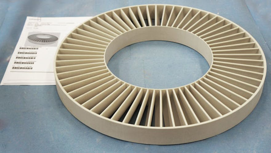

Voxeljet's additive manufacturing technology and service offers a work-around. Its 3D printers produce casting patterns quickly and cost-effectively, and with precision. The PMMA (polymethyl methacrylate, a synthetic polymer) models can replace wax models, and can be produced with speed and accuracy. No tooling is required —digital printing is based on CAD data — and the production process is repeatable regardless of the complexity of the design. In fact, designs can be developed regardless of current manufacturing techniques, and changes made as easily as revising the CAD data.
For example, voxeljet’s newest printers can produce a plastic model for a Francis wheel with a diameter of 500 mm in less than 24 hours. The material used in this application is PMMA, which softens at 73°C and burns without residue at temperatures over 700° C. This makes them well suited for use as investment casting models.

Models are built in a layering sequence. Plastic powder is applied to a building platform in thin layers, and then selectively printed with a solvent. The solvent ensures that the particles adhere together over a locally restricted area. The desired object is created by repeated application and printing of layers.
The unprinted powder supports the printed structure, so that even complicated free-form surfaces with undercuts can be created without a supporting structure.
After the printing process, the residual particle material is removed from the finished model, which is then infiltrated with wax. This provides the plastic models with a sealed and clean surface, which enhances on the finished quality of the investment cast parts.
The subsequent steps are the standard investment casting routine, the same as if the model had been formed in wax. After it is inspected, ceramic coatings are applied the completed models are fired in a kiln. Since the plastic models shrink as a result of heating, there are no breaks in the ceramic shell. Once temperatures reach 700°C or more, the molds will burn out completely without any residue.
The molds must be blown clean before any metal is poured, but there is no requirement to wash them. After the metal is poured, solidified, and cooled, they are unmolded and any feeding and gating systems are removed. The castings are deburred, and any other surface defects are address in customary ways.
