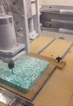

A pattern is machined in foam in preparation for evaporative casting.

“3D-printing of a pattern in order to then evaporative cast it may not be the best choice for all designs: It can be easier in some cases to machine foam stock and glue several pieces together to then evaporative cast it.
