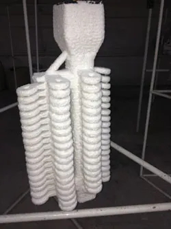

Next, they began making changes to the simulation model to eliminate porosity. They tried connecting the parts in different locations to the tree and adding exhaust tubes. Engineers corrected areas where porosity was spotted by opening up the feeding line from tree to part, changing the part orientation, putting more or less material into the tree and adding exhaust vents. In some cases, where the part was machined, it was possible also to change the geometry of the part.
In all, they simulated approximately 20 different mold design iterations, adding and reducing the number of parts per tree to see if it would be possible to reduce production costs. They arrived at plan for a clean part without porosity, keeping the number of parts on the tree the same in order to avoid increasing production costs. At this point they tested the new mold design and discovered that the results matched the simulation predictions. In the end, the number of rejects was reduced from 25% to 3%.
Plotz and Metalcast engineers also simulated another part, made of ASTM 315 steel. The original design called for 80 parts on a single tree, but there were difficulties filling some of the cavities. Prior to simulating the casting operation, engineers tried changing the tree geometry into three separate flows — but that made filling even worse.
They exported the 3D geometry from CAD into a STEP neutral file and loaded it into ProCAST. They used the software to create a surface mesh automatically, with a few manual fixes, and created a volumetric mesh using tetrahedral elements. They modeled the ceramic shell by entering the dimensions for each individual layer. The initial model matched the results they had experienced on the production floor.
Then, Plotz and Metalcast engineers began to evaluate new design alternatives by making changes to the part geometry, melt temperatures, metal composition, and mold temperature. They also made changes from the analytical side, such as heat transfer coefficients and number of time steps in order to fine-tune the accuracy of the analysis. After evaluating about 30 different iterations, they found one that provided excellent filling using a single tree. This new mold design is now running in production and providing optimal quality with a very low scrap rate.
