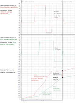

Comparison of the movement speeds with/without energy optimizer and comparison of the required energy.

Furthermore, the ROBOTstar controller is able to accelerate drives only as fast as required, not as possible, to meet the required process speeds. Reis graphed the overall effect of the process optimizations in terms of energy savings.
