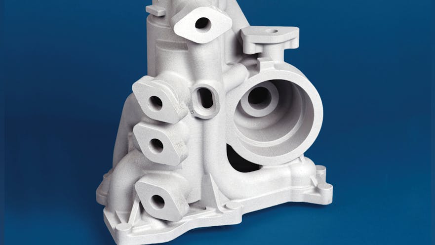

The award-winning design for aerospace investment casting is a pump housing developed and produced by O’Fallon Casting, O’Fallon, MO. “This pump housing is an excellent example of how the investment casting process offers the versatility to consolidate a fabrication made from multiple components, made from a variety of processes, into a single piece casting,” explained the foundry’s Jake Robben.
Aero engine pump housings contain complex internal passages so frequently they are produced by assembling multiple parts produced in several processes. Using investment casting, O’Fallon reduced the overall component weight while eliminating future failure points at the assembly location.
This winning design contains multiple interconnected core passages with varying diameters and depths. Combining thin walls, large masses of metal, and grade B metallurgical requirements, the component lends itself to the investment casting process. Working with the customer, and applying its own expertise, O’Fallon Casting reduced the number of weld openings from 10 to five, saving production cost and establishing a more robust part.
