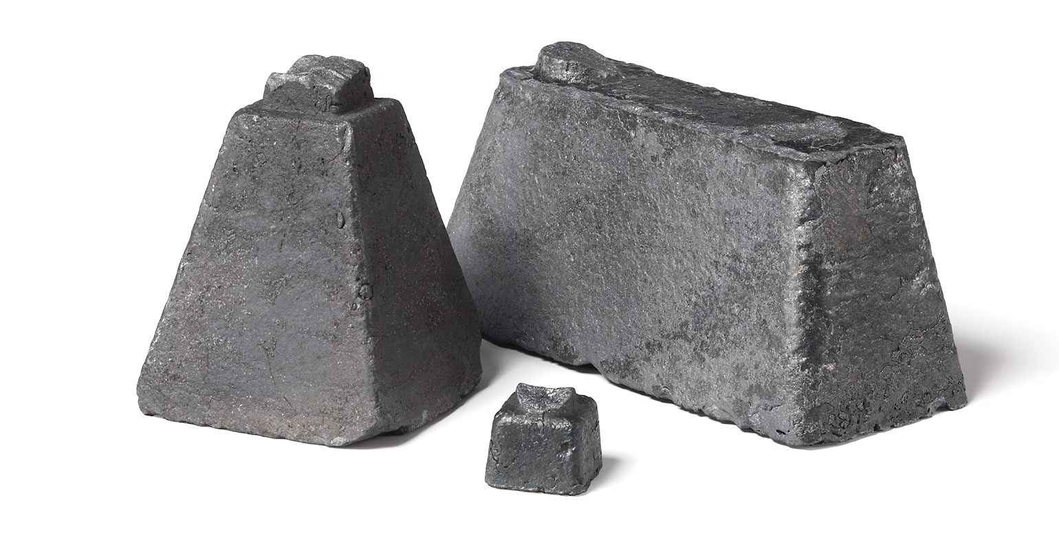

Solid cast (FeSi-based) inserts have been developed that have a balanced addition of bismuth and cerium, making this product a wise choice for increasing nodule count, thereby reducing the occurrence of chunky graphite. The SMW INSERT™ offers all the benefits of an in-mold inoculant plus protection from the costly defect know as chunky graphite. In relatively small additions (0.15%), the SMW INSERT™ will provide late inoculation that results in very little fade, and uniform-clean inoculation as close to solidification as possible.
In-mold inoculation with solid cast inserts is a mature technology that has gained wide acceptance in foundries pouring heavy section ductile iron castings. Now, there is a product that combines the ease of application- experienced with in-mold inoculation- plus the security of proper graphite formation in your heavy-section ductile iron. The SMW INSERT™ comes in several different sizes ensuring the proper inoculation rate for your difficult castings. The SMW INSERT™ is now commercially available and should be tried in your foundry.
