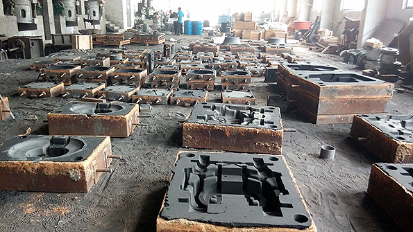

Q: How can I compare sand additive costs in use in order to determine the most economical choice for our foundry?A: When it comes to sand additives, you have several categories from which to choose.  There are organic- and inorganic-based additives, or hybrid blends that incorporate both types. The severity of the casting defect, the type of defect, and the metal being poured will determine which sand additive is the right fit for your foundry’s process in order to achieve the casting quality that is required.
The selection methodology and table shown here provide examples of how to calculate and compare the mixed-sand costs-per-ton of two different formulations when incorporating a sand additive into your process.

In this example, using Sand Additive 1 will cost $247.51 per ton of mixed sand; whereas, Sand Additive 2 will cost $115.16 — meaning a savings of $132.35 per mixed ton of sand used. Therefore, Sand Additive 2 would be the much more economical choices based not only on a lower price per pound but also the additional value of being able to use considerably less additive to get similar casting quality.
