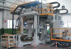

The GMBOND core machine being built in Rivoli, Italy, by FATA Aluminum.

The Machine
The machine was designed as two separate components: the sand system and the GMBOND core-shooting machine. This design was necessary due to the overhead space constraints, which were presented to FATA Aluminium by the Saginaw foundry during the design phase. Both the sand system and the core-shooting machine were designed to function independently in order to facilitate the myriad of research and development tests required for process optimization.
The sand system contains different elements required to prepare the GMBOND coated sand and transport the sand to the machine. The process begins with coated sand entering from a storage hopper located directly above the mixer. The sand is introduced into the chiller and then mixed with a metered amount of water. This equipment cools and hydrates the sand to its optimal operating condition.
Because of the limited operating space above the machine, the prepared sand is transported via an enclosed belt conveyor. The conveyor maintains the sand temperature via cool air from the chiller while it is transported into the receiving hopper elevated above the shooting head loading station. This belt is equipped with a cleaning station to ensure that sand remaining on the conveyor belt is removed for reuse.
The core machine consists of a receiving hopper located above the shooting head of the machine, one core shooting station, two purging stations, and one core removal station. The machine is designed to allow for the core unloading and core shooting to take place while the second core is in the air purge, or curing station. This allows for cycle time optimization consistent with customer demand.
The receiving hopper acts as a preload station for the shooting head and also facilitates the removal of any unused sand by discharging it into a sand-receiving flask. The shooting head moves transversely underneath the receiving hopper to receive a metered amount of sand necessary for core production. Immediately before entering the shooting head, the sand is augured from the conditioning hopper.
The shooting head is uniquely designed in that the sand is shot into the mold cavity. This is accomplished by forcing a metered amount of sand into the cavity via air pressure applied behind the sand column. This reduces the total amount of air introduced into the cavity resulting in a more uniformly dense sand core. After the sand is shot into the cavity of the heated metal corebox it is immediately transferred to one of two purging stations.
At this station the sand core is purged of moisture by the convection of warm air. The machine and the corebox are designed to facilitate air purging in different zones, either independently or simultaneously. The cured core is transferred via the cope to a core unloading station where an operator deposits it onto a pallet for unloading. The cope is then transferred back and closed to the drag half of the corebox. Machine and process cycle times are designed to be competitive with current coldbox processes.
