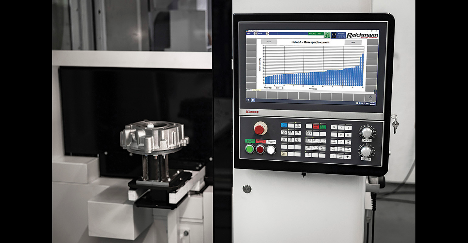

The new operating system for the MAUS grinding machines offers potential for Industry 4.0- and 5.0- compatible operations, and can support the user with the help of state-of-the-art technologies such as IIoT or artificial intelligence, to increase machine performance and productivity. With the new, "computer aided automatic tuning" self-optimization software for MAUS grinding machines (“MAUS CAAT” for short), Reichmann is taking a first step to making use of these possibilities. For the first time, machine data such as the spindle and drive power during operation are available to the operator in a structured form and can be used for optimizations manually and automatically.
Program codes created by machine operator for finishing castings are analyzed block by block with the help of MAUS CAAT. During the machining process of the first castings, the software specifically detects even the smallest defects and optimization potentials in the program. Wherever there is potential for increasing spindle and drive performance, the feed rate is increased iteratively. In this way, MAUS CAAT optimizes the machining program in the shortest possible time to achieve top performance with maximum time savings while making optimum use of the machine's output. In addition, the software adapts the machining speed to the weight of the casting directly during machine loading. This means that relatively light workpieces can be machined even faster. This results in a perfect interplay of human and machine intelligence.
"In initial tests, MAUS CAAT was able to speed up ready-optimized teach programs by over 15% and provide the appropriate input to the programmer for further optimizations. That's 15% more parts in the same time," reported Rafael Dineiger, international sales manager at Reichmann & Sohn GmbH. These accelerations would classically only be possible to a significantly limited extent using the multi-eye principle and with considerable time expenditure. "
