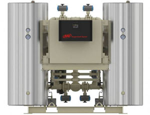

The Ingersoll Rand heat-of-compression (HOC) dryers low-profile design fits installations with low overhead clearances, and places critical service components easily within reach.
