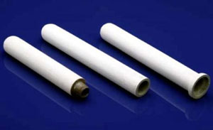

Pyrotek’s MAC thermocouple protection tubes are available with nipple, flanged, or plain ends.PYROTEK’s Metaullics Division offers a high-performance, advanced ceramic product especially for use in molten aluminum and zinc applications. The Metaullics Advanced Ceramic (MAC ®) thermocouple protection tubes reportedly offer excellent durability, thermal shock resistance, temperature measurement response, and long life.
Manufactured with a true composite, comprised of fine-grained silicon carbide and optional boron nitride, MAC protection tubes are extremely resistant to wetting by molten aluminum and aluminum oxide. Extensive trials and broad practical process applications show service life of three to six months can be achieved.
