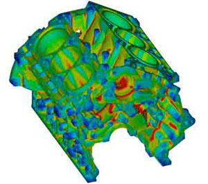

This image shows the Von Mises stress (dynes/cm2) of a V6 engine block composed of aluminum 380 after cooling initially within a steel die for 50 sec., and then in air for 540 sec. Residual stresses develop due to uneven solidification and cooling.
