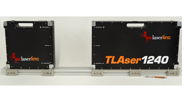

The TLAser1240 micrometer measures diameter, height, or width up to 9.1 inches (231 mm.)
LASERLINC INC., a manufacturer of precision-measurement technology for diameter, ovality, wall thickness, concentricity, eccentricity and inside diameter, introduced the TLAser1240 scanning laser micrometer, a single-axis diameter gauge for the inspection of large products, quickly and accurately, without contact.
The TLAser1240 micrometer measures diameter, height, or width up to 9.1 inches (231 mm) and is designed for use in industries such as metal, glass, wire and cable, and plastics and rubber extrusion. For metals and glass, the transmitter and receiver components can be separated to avoid the need to move product or equipment, as well as heat sources.
Among its design features: the TLAser1240 measure any material (even if it’s transparent), at a rate of 1,600 measurements per second, with a two-second repeatability (±.00008 in. /±2µm.)
An operator using two units together can achieve dual-axis (XY) inspection; three units can perform three-axis diameter and ovality measurement.
