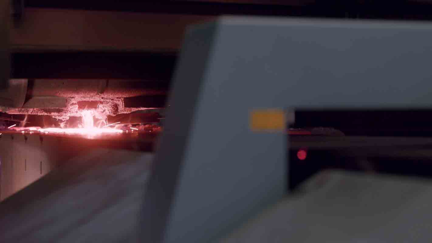

DISA is launching the Mould Accuracy Controller, or DISA MAC, a high-precision measuring device that captures mold-related mismatch, mold gaps, mold steps, and parallelism for each mold before pouring. The DISA MAC helps to identify issues around mold alignment before they become a problem — meaning, before they result in unnecessary rework or scrapping of any castings.
The DISA MAC device consists of a bridge-like scanning bracket that is mounted across the mold string between the molding machine and the pouring unit. This bracket is equipped with laser sensors that scan continuously along the mold string, tracing specifically designed impressions on each mold.
Customized software uses these readings to calculate critical alignment parameters and identify issues according to customer pre-set limits. A warning light on top of the bracket alerts the operator to any issues via a simple traffic light system.
