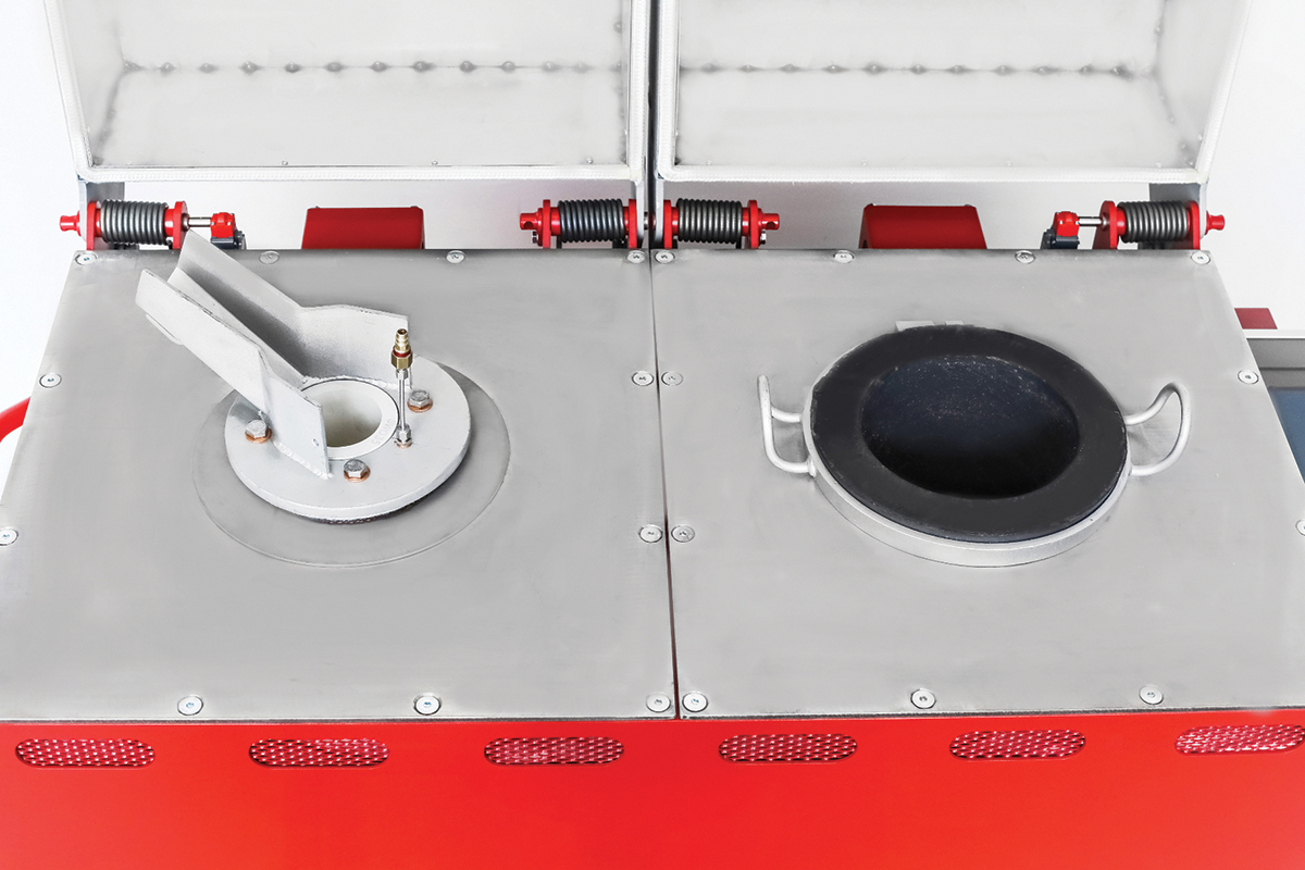

The StrikoWestofen proposal to the problem of thermal shock is a mobile heating station that raises the temperature of ceramic components uniformly to the ideal temperature. The unit can be used anywhere and can be placed immediately adjacent to the dosing furnace. This promotes better foundry logistics, as ceramic parts can be used after heating without having to be transported first.
The station is heated electrically using a CEE 16-ampere standard plug; no special adapter is necessary.
In addition, the new station has two separate heating zones that can be regulated independently. This allows components to be heated to different temperatures at the same time.
Freely selectable adapter rings allow flexible use. They also simplify handling for the employees and protect them from injury.
