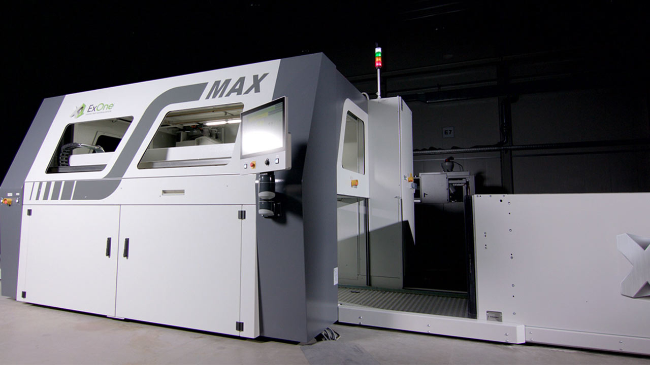

THE EXONE COMPANY, supplier of binder-jet 3D printing systems recently introduced a new 3D printer for industrial sand, the S-MAX Pro™. According to the developer, the new printer’s speed, reliability and precision make it an excellent choice for both prototyping and industrial series production.
S-MAX Pro can achieve printing speeds of up to 135 l/h (18 sec/layer) and can therefore 3D print two full 1,800x1,000x700 (mm) job boxes, each with a volume of 1,260 L, in just 24 hours.
Other design features include a new, highly efficient printhead and a fully automated recoater.
The molding material can be replaced quickly and straightforwardly, making the S-MAX Pro ideal for the production of complex parts with various casting materials and the perfect 3D sand-printing solution for the digital foundry of the future, according to the developer.
The "box-in-box system" is designed to meet the market requirements for 24/7 operation, in fully automated, scalable production.
The control system includes cloud connectivity and Industry 4.0-integration capabilities. The inline process and digital machine monitoring make it a flexible and location-independent process, meaning that printing errors can be detected early and corrective action can be taken automatically.
