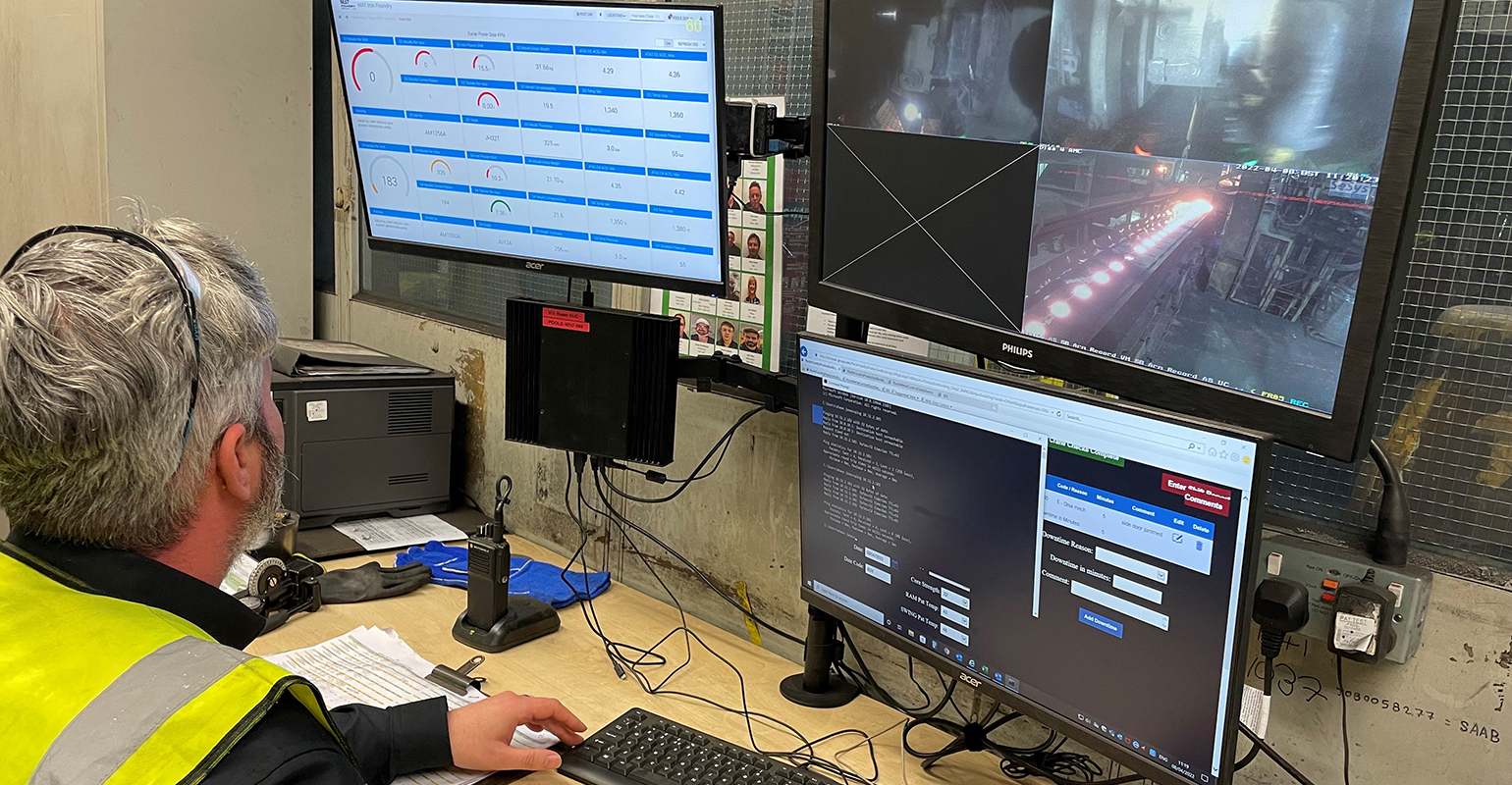

Eurac Poole will deploy Monitizer | Prescribe for both of its two DISA vertical molding lines. The program uses AI and cloud-based data analysis to optimize the entire molding process. By analyzing live data, it can recommend changes to process parameters that prevent defects occurring.
“Our long partnership with DISA and other foundries’ successful Prescribe deployments give us confidence that this technology is well proven and the correct next step in our digital journey,” Lindfield said. “In fact, this project is very low risk for us. Monitizer | Prescribe uses the same platform as our existing Monitizer | Discover tool and has sensible upfront pricing with ongoing subscription-based payment.”
Driving down scrap will improve Eurac Poole’s profitability and reduce energy consumption.
Prescribe’s automated suggestions also will help fill a potential knowledge gap at the foundry. “We lose a huge amount of expertise when older staff retire,” according to Lindfield. “Upskilling takes training and time. Prescribe will analyze our historical data to learn which inputs work best, and will guide us in adjusting our process to reach the best possible quality. Not letting operators work by trial and error will reduce process variability too.”
