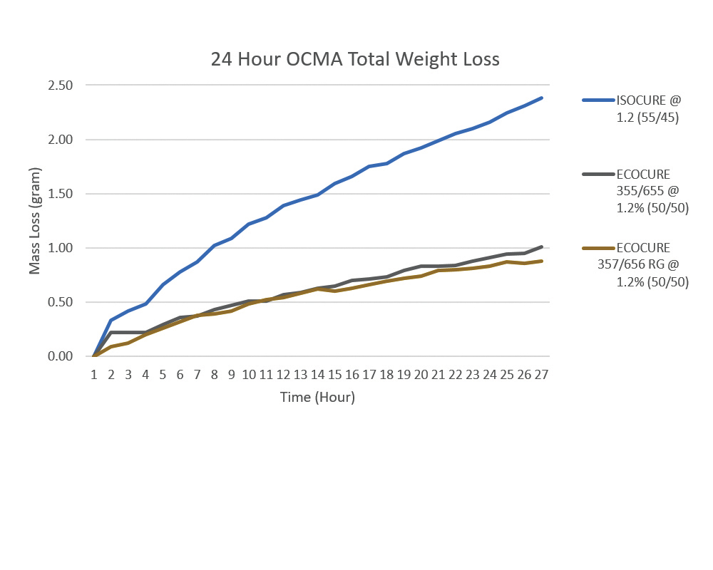

ECOCURE™ BLUE has the lowest available level of volatile organic compounds and can be considered as VOC-free, according to EU regulations. And, the new technology contains less than 1% free phenol and non-detectable free formaldehyde, which makes it the cold-box system with the least emissions in the core shop.
During pouring, cooling, and shakeout, there are basically are two kinds of emissions: BTX and phenol emissions. The BTX emissions are more likely to stem from the polyurethane pyrolysis than from the solvent package of the binder. Therefore, these BTX emissions can only be significantly lowered by reducing the binder quantity and increasing the binder efficiency, as the ECOCURE™ binders do. With less free phenol, the ECOCURE™ BLUE enables the phenol emissions to be drastically reduced during pouring.
ASK also has adapted the ECOCURE™ line to accommodate other important health concerns. For instance, ECOCURE 359/659 RS has been developed to reduce smoke and improve “fence-line” issues.
The reduction in smoke promises also to improve working conditions, a major occupational health and safety issue for foundries today. In addition, ASK Chemicals has produced ECOCURE 355/655 and 357/656 RG to offer exceptionally low VOCs and to help foundries meet the Occupational Exposure Limits (OEL) for phenol established by U.S. regulators.
