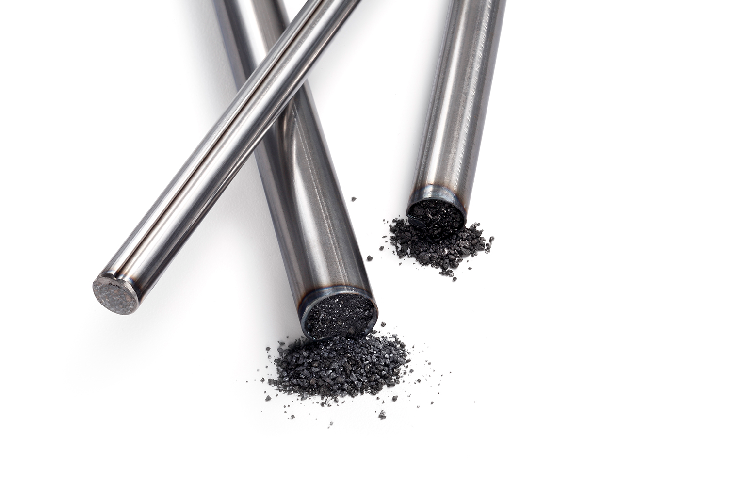

Cored wire consists of hollowed steel wire packed with fine-grained material. Cored-wire filler may be either pure Mg, Mg alloy, FeSiMg alloy, FeSi-based inoculant, FeSiMg pure La, or any blend of these options. Using wire feeder / injector, the wire (single or multiple feeds) is fed to the bottom of the ladle filled with molten metal, or into a molten metal stream/pouring unit. The main advantage here is that you always know exactly the treatment size and composition. And, with this method you achieve unparalleled flexibility with regard to fluctuating initial iron conditions and, thus, consistency in final iron can be achieved. Cored-wire Mg-treatment process also can handle desulfurization and Mg-treatment in a single step in cupola-produced ductile iron.

•  Cored wire composition can be customized to customers’ specific needs. ASK Chemicals has designed over 700 different cored-wire formulations, ranging from pure magnesium wire to various blends of FeSi-based alloys for inoculation or magnesium treatment.
•  Encapsulated alloys are wrapped in steel sheet, protected from atmosphere and oxidation, to prevent weakening of alloy potential.
