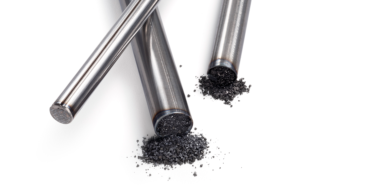

On the contrary, the cored wire process’ unparalleled reproducibility is achieved because treatment parameters are calculated only after the ladle has been filled and all relevant iron characteristics properly measured, which deems it independent from the prior process variations.
Another consideration is the protection of employees from emissions generated during magnesium treatment. For several reasons, the exhaust system is habitually installed further away from the treatment ladle. This results in substantial release of effluents into the production hall or demands a very high capacity purification system capable of handling enormous air flow. With wire treatment, pollutants are confined to and readily captured right where they occur.  A much higher level of efficiency and effectiveness is thus achieved.
Above all, iron treatment with cored wire offers the possibility of precise analysis guidance, cost control, and documentation. The knowledge of the treatment ladle content characteristics allows for precise calculations to be made. As a result, desired target values are achieved in a consistent manner, thus compensating for the fluctuations in the base melt and tightening the production range. When wire injectors are integrated to the existing equipment database (cooling curve analysis, thermal probes, scales…), this calculation occurs automatically on the fly at a mere push of a button.
From the wire perspective, particularly relevant parameters are the composition of the filling powder and the wire diameter. Which brings us to another benefit of cored wire. The cored wire composition is completely flexible and often is fully tailored to a particular customer’s process needs. Multi-feed setup is available too, whether that be multiple lines of the same wire for large treatments of 50 metric tons, or each line carrying a different type of wire, as in the SinterCast™ process in the production of compacted graphite iron (three wires: magnesium treatment, magnesium correction, and post inoculation.) This promotes a more efficient workflow.
