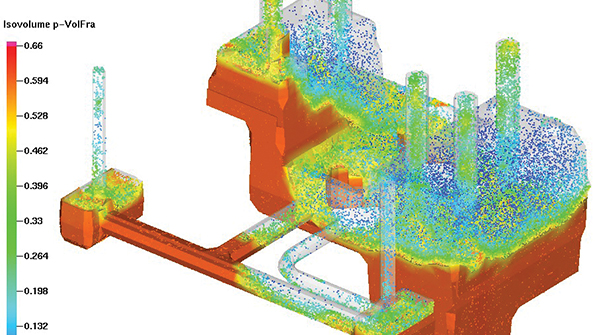

To help minimize time and frustration, and to maximize quality and productivity when starting up new core boxes, Arena-flow software uses Computational Particle Fluid Dynamics technology to model blowing and curing of sand cores.

To help minimize time and frustration, and to maximize quality and productivity when starting up new core boxes, ASK Chemicals’ licensed Arena-flow software uses the revolutionary Computational Particle Fluid Dynamics (CPFD®) technology to model blowing and curing of sand cores.  The software has been extensively tested and validated in core rooms across several continents, and has the high level of accuracy needed to link simulation results and core-box performance.  Based on the true physics of sand and air-flow, Arena-flow has the ability to take into account critical, real-world information and generate meaningful data, such as:
•  Sand particle size distribution (sieve/pan analysis), multiple sand types and additives;
•  Core filling and miss filling, variation in density;
•  “During process” information on sand and air speed;
•  Magazine performance and the ability to predict rat-holes;
•  Amine-based curing with varying pressure profiles.
