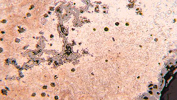

Clockwise from top, left: a tundish ladle before ductile iron production; a tundish ladle after eight hours of ductile iron production; image of a slag inclusion, captured via SEM; image of a dross defect in ductile iron.
Q: Lately, we’ve found a lot of slag and dross in the ductile iron castings we pour. Normally, this is discovered during machining operations, at which point in the process it can be very expensive to resolve. What is the best way to reduce the occurrence of slag and dross in ductile iron?A:Slag can never be fully prevented, but with a few steps it can be managed.  Among the steps that will help manage the problem are: paying attention to charge materials (rust, debris, oil, and sand); keeping the melt covered at all times (this reduced exposure to the atmosphere); and maintaining furnace and ladle refractories in optimal condition for pouring. In addition to these steps, sound slagging practices are always encouraged.
On the other hand, dross is the byproduct of the magnesium treatment. Magnesium loves oxygen, and when introduced to cast iron the magnesium oxide compound (MgO) is formed. MgO is formed during the treatment, but it continues to be formed during the subsequent handling of metal.  In addition to sound foundry practices, as mentioned above, there are additives that can be added to the ductile iron to reduce slag and dross defects.  DISPERSIT™ is a metallurgical product that, when added to ductile iron, significantly reduces those time- and cost-consuming defects.
