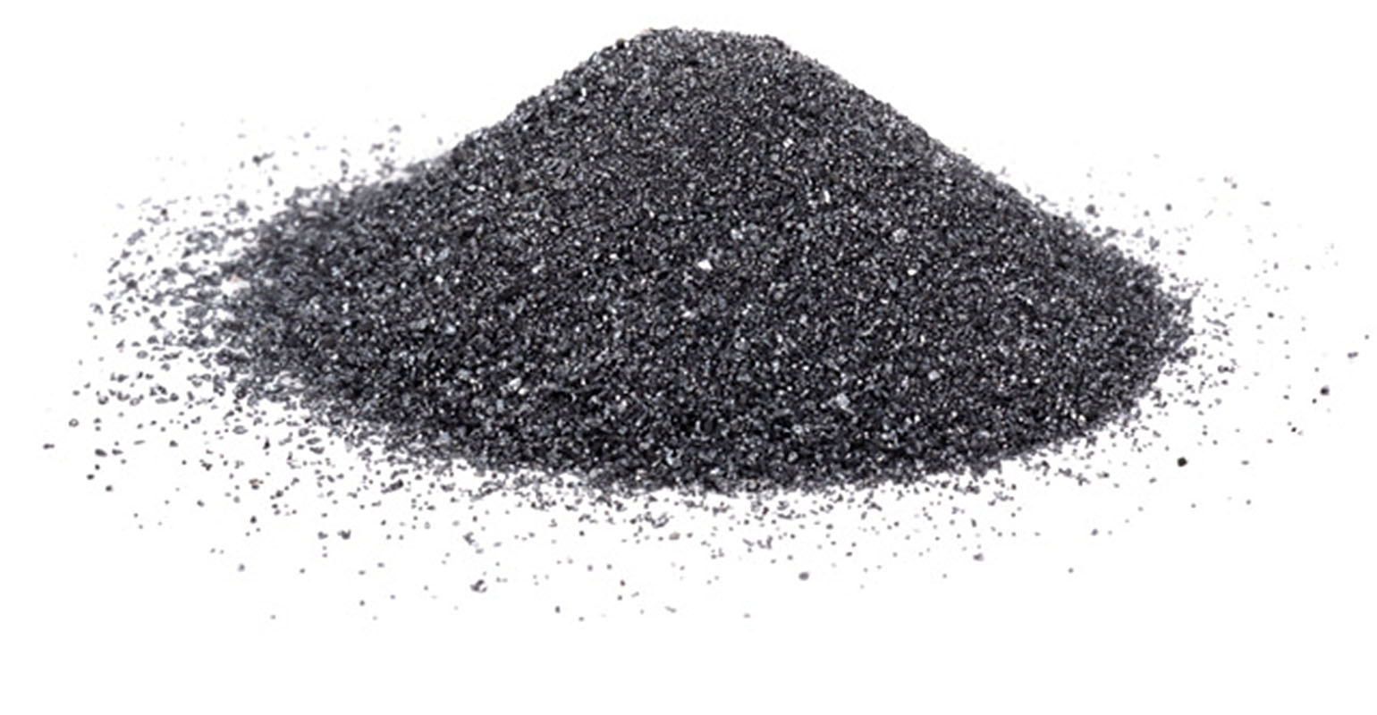

Pre-conditioning involves adding a specialty alloy before magnesium treatment, in order to have a molten metal that is more susceptible to magnesium treatment and inoculation. We have a product — a preconditioner called VL(Ce)2 — that is ideal for ductile iron practice. At the small addition rates of 0.05-0.1%, the product can increase the nucleation sites for ductile iron, and in turn this will prepare the molten metal for a more effective magnesium treatment. In the end, it will have a positive effect for the final castings.

A: VL(Ce)2 is a pre-conditioner comprised of silicon, calcium, aluminum, cerium, manganese, zirconium, and iron. All these materials work together to give a strong inoculation to the molten metal, and help to achieve more proficient magnesium treatment. To put it simply, its primary strength is the variation of its constituent elements; Each one brings a certain benefit that will enhance the properties of the final casting.
