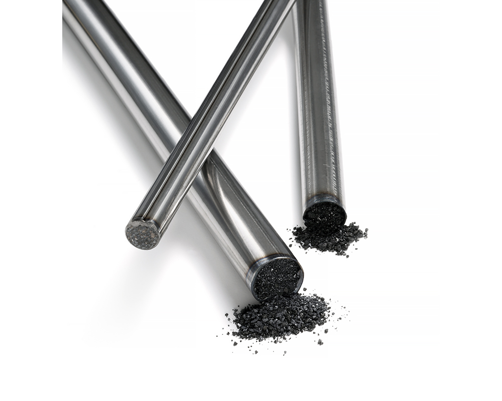

However, one approach can apply both automated treatment and inoculation practice. Cored-wire practice introduces a hollow wire filled with powder alloys to the molten metal. The alloys in the wire may be MgFeSi for magnesium treatment (for DI or CGI), and/or inoculation material (for DI, GI or CGI.)
The wire is drawn from a coil that is mounted to the machine and feeds it to the molten metal. After it is set up, the machine has a human-machine interface (HMI) for installing required values of the melt and to introduce process automation. With these input values the machine will calculate the length of wire necessary to feed into the metal. Because this process is automated, it brings more accuracy to the sequence of adding magnesium and inoculation materials.
These values are necessary to calculate how much wire is required in the molten metal. The coil normally reports the alloys in grams per meter of wire, and the information required by the computer will allow it to accurately calculate the length of the wire necessary to add the right amount of alloy.

The typical products for ductile iron treatment and inoculation are MgFeSi and foundry-grade FeSi. However, we also offer pure magnesium wires and other inoculation products, such as ferrosilicon with zirconium, strontium, aluminum, calcium, bismuth and even cerium. Your selection depends on what you seek to accomplish at your foundry.
There also are different wire diameters that may be chosen for cored-wire practice. Standard diameters for wire are 9 and 13 mm, available for the different cored wire coils. On special occasions, a 16-mm diameter wire may be offered.
The different diameters will ensure that more material can be inserted per meter of wire. The larger diameters provide the ability to use less coil length, and also may reduce the wire-feeding speed for the mechanism.
