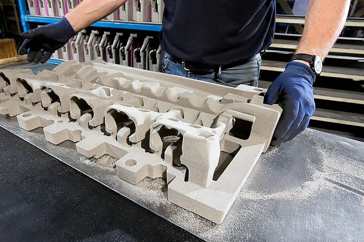

Q:  We produce molds and cores using phenolic urethane resin-bonded sand, but recently we started to see several small spots in the molds after they are coated. The spots appear randomly and the sand is soft to the touch: no matter how long we wait they do not harden. What are these  spots and how do we control them?
A: The “spots” you describe are known as “resin balls.” Several factors may cause them to form, and often it can be a daunting task to remedy them. Listed here are the most common causes, and some recommendations for preventing them in a molding process.
