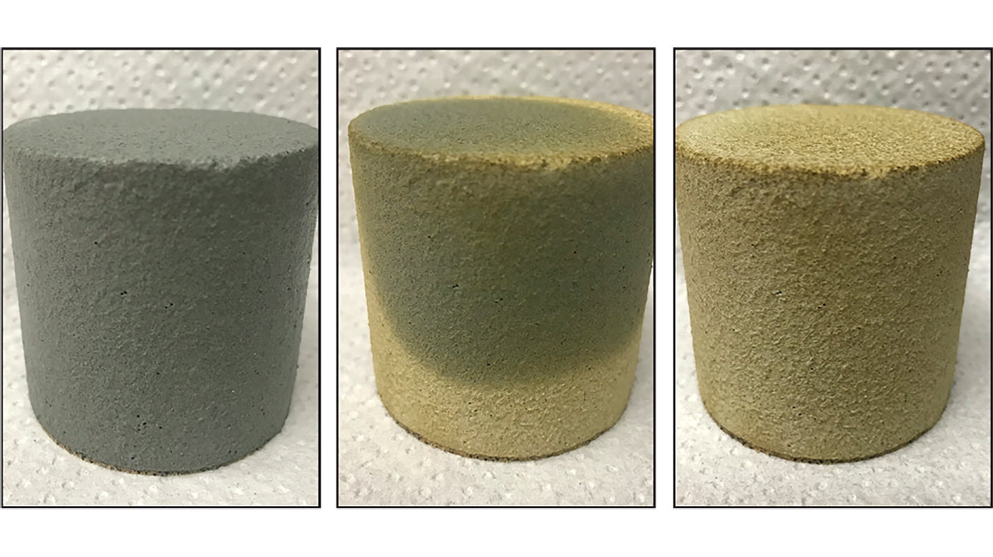

To accomplish this, a properly designed refractory coating blend that insulates the core and provides consistent cooling rates will promote good nodularity in compacted graphite iron castings. This type of coating also can act as a barrier to prevent sulfur pick-up from some sand binder systems, which is known to reduce the volume of flake graphite formation.
ASK Chemical’s highly engineered water-based refractory coating, ISOCOTE BPG-TM, is proven to accomplish these critical performance requirements.
ISOCOTE BPG-TM also contains a drying indicator that will change the color of the coating from blue (wet) to light yellow (dry) when used on most types of cores and molds. It must be noted that the initial color of the sand may have some effect on the final color of the coating. It is common for this coating to revert to a blue color if moisture is present.
