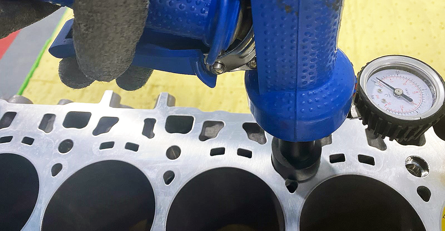

One notable development was the ‘Selective Impregnation’ process by Impregnation Solutions Ltd., which emphasizes simplicity and low-cost, as well as performance. Selective Impregnation accurately applies an impregnation sealant only to an area of a casting with an identified leak, and uses a hand-held Spot-Seal pressure impregnation gun. (Bench-mounted and automated options also are available.) The method uses a range of rubber washers from which the most appropriate is selected and positioned onto the casting to match the precise point of porosity.

Because Spot-Seal is a localized pressure impregnation process, it is applied directly to the area of the casting where a leak is discovered. In many cases, this can be isolated to a machined bolt hole, so no other part of the casting is affected.
The sealant cures rapidly within the porosity but any residual surface sealant remains liquid, so it's rinsed out easily with no risk of contamination and damage. The process is fast and recovery is typically 100%, according to the developer.
Within the larger engine manufacturing process, Spot-Seal impregnation is both manual and mobile so it can be applied to the part on the line. Then, the workpiece can be returned to production or assembly in short order. The process also can be automated for high volume applications.
