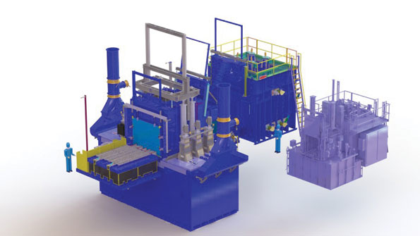

In recent months, the Applied Process group added an even larger, batch austempering system at its Monster PartsTM Division in Oshkosh, WI.  This unit is the largest integral quench batch furnace in the world with a working envelope of 7 m3 and a maximum gross load of 9.1 metric tons.  Figure 1 is an illustration of this one-of-a-kind Monster PartsTM furnace in comparison to a standard universal batch quench (UBQ).
