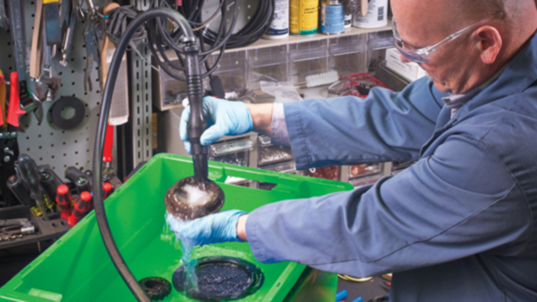

WALTER SURFACE TECHNOLOGIES introduced CleanBox Flow to its Bio-Circle series of manual industrial parts washing systems. Suitable for the bulk cleaning of small- to medium-sized parts, the compact-sized CleanBox Flow is specially designed for use with Bio-Circle CB 100, the powerful, natural water-based solvent that is biodegradable and VOC-free. Together, the CleanBox Flow and CB 100 offer a safe, efficient, cost-effective, and eco-friendly replacement to solvents in virtually any type of MRO environment.
The CleanBox Flow system helps contribute to a safer and healthier working environment by cost-effectively replacing the need for harsh industrial solvents. The CleanBox Flow and CB 100 help improve the health and safety of workers by minimizing dangerous chemicals that create fire hazards and toxic exposure risks, while also reducing the need for costly waste removal, ventilation systems and insurance policy premiums.
The CleanBox Flow parts washer system consists of a sink and flow-through cleaning brush, a basin and heavy-duty pump that circulates through heavy oils, greases and contaminants. When paired with CB 100, the CleanBox Flow allows quick and easy removal of hardened greases, oils, and residues on small to medium industrial parts. Its heavy-duty construction and ergonomic design withstands rugged manufacturing environments.
