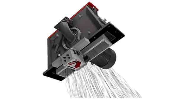

The MaxImpregSystem is a series of sensors that define optimal blast patterns for surface finishing ldquoproducing the most effective and efficient blasting processrdquo and the measured blast pattern data is evaluated either by a separate electronic evaluation system or the PLC
Automatic Blasting Control System
Oct. 27, 2014
Pneumatically operated sensors define, optimize surface-finishing patterns Mounted at periphery of the “hot spot.” Redefines modernization, new investments Reduces operating, maintenance, replacement costs
The new RÖSLER Max-Imp®-System is a series of sensors that according to the developer guarantees precise and optimal blast patterns for surface finishing, “producing the most effective and efficient blasting process.” The pneumatically operated sensor is mounted at the periphery of the “hot spot.”
The measured blast pattern data is evaluated either by a separate electronic evaluation system or the PLC.
After just 3 to 5 seconds the results can be read on the system’s separate control box or the operator’s panel display.
