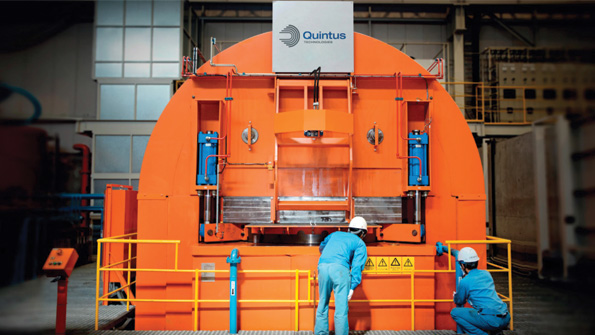

Quintus Technologies installed this hot isostatic pressing unit for a Japanese manufacturer Itrsquos described as the largest HIP in the world

With a work zone of 5.25 ft diameter and operating pressure of 2000 bar, the Quintus hot isostatic press expanded the Alcoa Whitehall, MI plant’s capabilities for processing nickel- and titanium-alloy investment castings and 3D printed parts.
Last year, Quintus Technologies (at the time known as Avure Technologies) was contracted to install a $22-million HIP system for the Alcoa Howmet investment casting operation in Whitehall, MI. The aerospace-focused plant already had eight HIP systems in place, and the new machine (with a 5.25-ft. diameter by 8.5-ft high work zone, it is the largest) was important to add capacity for  the rising volume of titanium and nickel-alloy jet-engine components being produced and processed there.
At the time of the order, the new Alcoa press also was described as the largest HIP unit in the U.S. operating at 2,000 bar (29,000 psi) and 1,250°C (2282°F), according to the developer.
The new machine also supports Alcoa’s growing output of 3D-printed parts. It is the ninth and largest HIP system Alcoa has installed at Whitehall.
