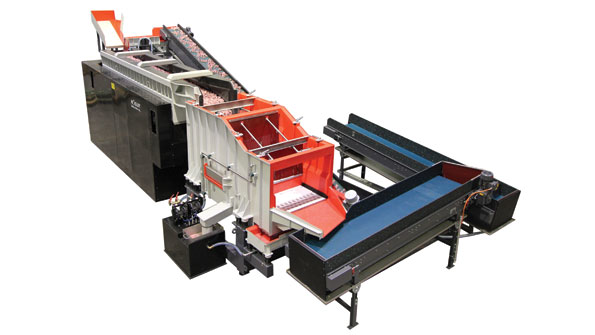

Rosler’s continuous-feed finishing system consists of a linear continuous feed machine (type R 550/4600 DA) with a usable length of 4.6 meters (15 ft.) The functions of the existing workpiece loading system and hot-air belt drier were integrated into the overall system controls of the finishing process. “Rosler met all our technical requirements and provided valuable support in optimizing our finishing process,” Buzek explained.
About 30 different workpieces with a maximum diameter of 300 mm (12 inches) are currently processed in the R 550/4600 DA. Because it can handle parts with diameters of up to 400 mm (16 inches), the machine offers a high degree of flexibility for future production program changes or additions. More than that, the automatic workpiece loading sequence can be modified easily to incorporate a new workpiece loading system, which may be installed at a later time.
Depending on the specific individual designs, castings are fed into the finishing system at cycle times between 30 and 60 seconds. The single curve U-shaped cross section of the processing channel guarantees optimal movement of media and workpieces through the machine. This novel design and the use of high-performance, type RKM plastic media achieves exceptionally high quality finishing results, with a maximum processing time of eight minutes.
Processing time can be adjusted simply by increasing the inclination of the processing bowl. Compared to systems with a separate vibratory discharge channel, the workpieces are travelling through the machine at a constant speed. This prevents any jams, which could damage the workpieces.
Separation and rinsing station — To prevent any damage to the delicate workpieces during the separation cycle, a multi-deck vibratory screening unit was adopted, which contains two steps with minimal drop heights. The undersize media classification system is equipped with an adjustable bar screen, which allows Kovolis to decide at which dimensions undersize media must be discharged.
Because the finished castings do not undergo a separate cleaning step to remove media fines from their surface, the separation unit is equipped with a spray-rinse station. After the workpieces have passed through the hot air belt drier, they go straight to packaging or machining.
