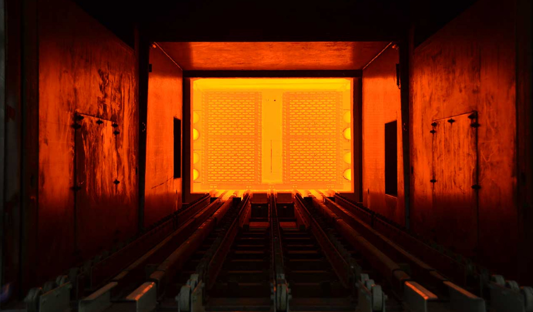

The AFC-Holcroft UBH line will include a batch-style carburizing furnace, two expansion modules to increase endothermic generator gas output, a rotary-hearth reheat furnace for press quenching, a continuous integrated parts washer, and temper furnace.
A spokesperson described the UBH system as similar to its UBQ (universal batch quench) integral quench batch furnace, which performs carburizing, carbo-nitriding, neutral hardening, ferritic nitro-carburizing, normalizing, annealing, spheroidize annealing, and stress relieving, on a wide range of cast, forged, and machined parts for drivetrains and axles, transmissions, shafts, fasteners, bearings, and gears. A design distinction, however, is that the UBH has a top-cooling function, without a quenching tank.
“The batch furnace itself has an effective load size of 72 in. by 72 in. by 56 in., with a gross load capacity of 13,000 lbs., which is considered very large for this type of equipment, but is in fact one of AFC-Holcroft’s standard sizes,” according to AFC-Holcroft sales manager Tracy Dougherty.
