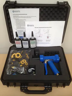

The manual Selective Impregnation kit from ISL.
“To date, manufacturing companies have either invested in large, purpose-designed impregnation facilities or sent leaking components to a dedicated sub-contractor,” explained Paul Young, director at ISL. “This can result in production delays, unnecessary inventories, transport costs, and potential handling damage – all issues that can now be addressed by the Selective Impregnation system, with clearly definable savings in terms of time, manpower and costs,” he said.  “As a result, production, budgeting, and operational efficiencies, alll are significantly enhanced.”
The Selective Impregnation process accurately applies the impregnation sealant only to the identified leak area, using a simple to operate, hand-held Spot-Seal pressure impregnation gun. Bench-mounted and automated options also are available.  The method uses a range of rubber washers from
The ISL Selective Impregnation system is supplied with a choice of porosity
sealants, to address multiple types of porosity.
which the most appropriate is selected and positioned onto the casting to match the precise point of porosity.
Next, a pressurized gun is applied, both to clean the porosity and then carry out impregnation, with the operation completed by rapid curing.  “Typically, the process takes one to two minutes and the casting can be re-tested in as little as 30 minutes,” Young added.  “Significantly, because the sealant cures and hardens inside the casting and not on its surface, there is no surface residue to be removed.”
For the sealant, IPL offers three different formulations. Each one has a different viscosity so that the appropriate sealant can be selected in relation to fine, medium, or gross leakage rates. “This is not possible with vacuum impregnation where there is only one viscosity,” Young noted, “so often castings with a gross leakage rate are not recovered, even though the casting is sound.”
