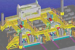

Auto Chassis Intl. commissions Fomet automated pouring furnaces
The dual pouring furnaces are capable of filling up to 500 molds per hour.
