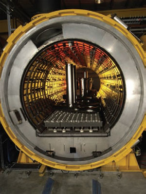

Solar Amospheres uses a 10-bar vacuum furnace at its commercial heat-treating operation in Western Pennsylvania to anneal stainless products without damaging the bright finish, in a simple, closed-loop process. The same plant is the site of a 20-bar horizontal vacuum furnace (shown here), installed earlier this year. The 40-in. wide, 50-in. deep, 36-in. high, 3,500-lb load chamber was custom-designed and built by affiliate Solar Manufacturing. The furnace is able to increase core hardnesses for large cross-sections (e.g., gears), and the commercial heat-treater explained that the furnace’s excessive pressure and high-speed gas velocities simulate oil quenching. But, using inert gas as an alternative to oil minimizes distortion and is a cleaner and greener process.

Commercial vacuum heat-treater Solar Atmospheres developed an advanced gas-cooling technology that it introduced recently, which makes it possible to offer a two-step heat-treating process to anneal and bright age-harden various precipitation hardenable (PH) grades of stainless steel in a vacuum furnace without breaking the vacuum.
PH stainless steels 17-4 and 15-5 must be cooled to below 80°F from the annealing temperature for complete martensitic transformation prior to age hardening. In a similar way, PH stainless steels 13-8 Mo and 17-7 and 15-7 Mo Condition TH 1050 are required to be cooled from the annealing temperature to below 60°F relatively quickly prior to aging. Once PH stainless steel has been exposed to an air environment after annealing, it is especially difficult to preserve its “brightness,” or to stop oxidization from creating a gold/blue shade during age hardening.
Solar Atmospheres reports its gas cooling technology makes it possible to anneal PH stainless steel products, cool them to below 60°F, and age harden them, all under vacuum conditions in a single heat-treat batch in a vacuum furnace. It adds that the results are “consistently clean, bright, non-discolored parts that meet specification processing and material property requirements.”

As explained by a source, the closed-loop process requires only a vacuum furnace, a vacuum chamber, and a gas-cooling system. It starts with solution annealing or austenite destabilizing (depending on the alloy) at elevated temperatures. This is followed by an inert gas, positive-pressure quench to the furnace ambient temperature of 80°F or 60°F (again, according to the alloy.)
The next step is to stabilize the work at the requisite ambient temperature. Following this, the work is heated to an aging temperature and held there for the period necessary to complete the precipitation hardening process, also determined by the alloy type and condition. Solar Atmospheres uses state-of-the-art microprocessors for cycle control, optimization, and repeatability.
