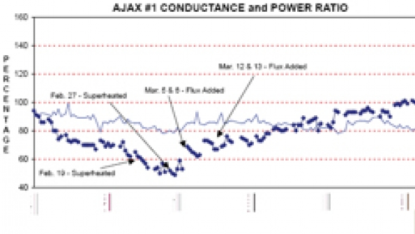

Foundry X is an actual example of fluxing and the adverse economic impact of slag buildup. It melts ductile base iron in a 35-ton vertical channel furnace utilizing a twin-loop water-cooled inductor. After installing a new inductor at the end of 2005, Foundry X started to experience severe buildup in the throat/boat section of the inductor in January to mid-February 2006, just weeks after the inductor was replaced.
Conductance and power ratio data compiled at Foundry X, January 3 through early July 2006.
From previous experience, Foundry X knew that the downtime associated with a clogged inductor would be very costly. Typical downtime when the throat/inductor clogs is five days. During this period, Foundry X had to completely drain the furnace, ream out the throat opening, and perform a “hot inductor change,” estimated at roughly $90,000 (total costs in downtime and lost production.)
Normally, the conductance ratio (a measure of inductor electrical efficiency) at the beginning of a new refractory campaign is close to 100%. Typical conductance ratio history will show a gradual decline during the first three to four weeks (declining to 75 to 85%), and then stabilize while the power factor remains relatively unchanged. The dramatic decline in conductance ratio (to less than 75%) at Foundry X’s channel furnace is shown in the graph.
Methods employed by Foundry X to remove buildup were periodic superheating on a low heel, the addition of silicon carbide followed by a periodic superheat, and “green poling”; however, none of these procedures seemed to improve the worsening buildup problem. The conductance ratio continued to drop into the low 50% range.
In early March, Foundry X embarks on a two-day fluxing procedure using EF fluxes. The flux was added to a minimum molten heel free of slag. For the procedure, the inductor was turned to high power to superheat the molten iron to 2,850°-2,900°F, followed by the addition of 0.1% EF flux (2 lb/ton). The superheating was continued for three additional hours. Then, the furnace was cooled back to normal holding temperatures and the slag was removed. This procedure was repeated the following day, whereupon it was observed that both conductance and power ratios significantly improved. A second fluxing campaign commenced the following weekend using the same 2 lb/ton addition. The graph summarizes the significant improvement in conductance ratio. Repeating the fluxing procedure later showed further improvement, and the conductance ratio was restored to normal levels (mid 90’s).
