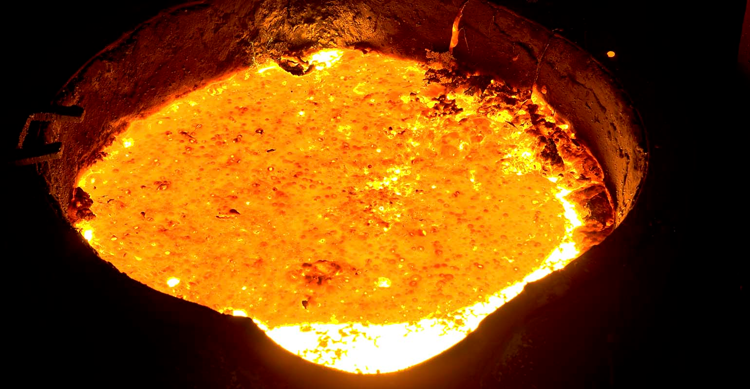

Coming to the surface
In steel melting and processing, the molten metal surface is shrouded to the maximum possible extent in order to prevent steel contact with the atmosphere. In iron melting little emphasis is directed at stopping atmospheric contact. In fact, electric furnace manufacturers promote keeping the molten bath clear of all slag. This leads to the molten iron surface having direct atmospheric contact, which produces excessive iron-oxide content in the cover slag.
Steelmakers attempt to limit exposure to atmospheric contact but they know that is nearly impossible. Consequently, aluminum is added to heats of high-quality steel. The aluminum combines with all free-oxygen atoms, forming inert oxides. 0.03% AL is added to control the minute quantities (1 PPM = 0.0001%) of free-oxygen atoms always present. A hundred-fold excess of aluminum is needed to ensure – by the laws of probability – physical contact between the aluminum and oxygen atoms.
In iron melting and pouring, aluminum cannot be used to tie up free-oxygen atoms: Residual aluminum causes pin-holing defects in iron above 0.010% Al levels.
In iron melting, iron oxide forms during the melt cycle. More iron oxide forms in cupola melting than in electric melting. Mixing action in the EF produces the iron oxide, and high-mixing action furnaces produce higher iron-oxide levels. The level of iron oxide in cover slags controls the level of free oxygen added to the iron bath.
