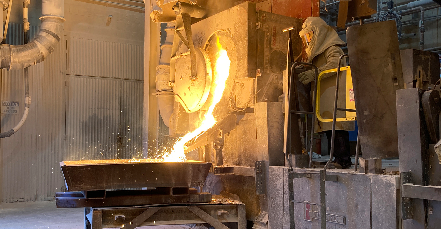

American Flux, a producer of ESR flux and molybdenum refining agents, installed two, 300-kW Inductotherm VIP® Power-Trak® units, and one Melt-Manger Plus® control system for each power unit; as well as a new, cooling water system.

The new systems consists of two VIP® Power-Trak® units at 300 kW, versus the earlier 250-kW VIP® Power-Trak® units; a completely new, closed-loop water system, with adiabatic coolers located on the ground for easier access; and a Melt-Manger Plus® control system.
The previous dry-air cooler water system had been installed on the roof of the plant and it was difficult to reach when it was necessary to carry out preventative maintenance checks or to investigate any other issues. The VIP® power supplies were designed to occupy the same space and location as the prior units, and the water system was moved from under the melt deck to behind a wall for much easier access.
Every decision about this update was made to improve the functionality of melting area for the next 25 years. Because they were able to continue using the existing furnaces with the new power supplies, American Flux achieved productivity and performance improvements with significant savings in capital-equipment and installation costs.
The investment had an almost immediate effect. With the new equipment in place, American Flux was able to increase its productivity by nearly 30% in the first month.
“We just completed our first full month of melting with the new power supplies,” Stuart Rudoler, CEO, reported late last year. “I’m thrilled to report that we produced 330,000 lbs. of flux in November. Our highest amount ever with the old power supplies was 250,000 lbs./month. “It is very rare that we get a 30% improvement out of any upgrade right of the box,” according to Rudoler.
