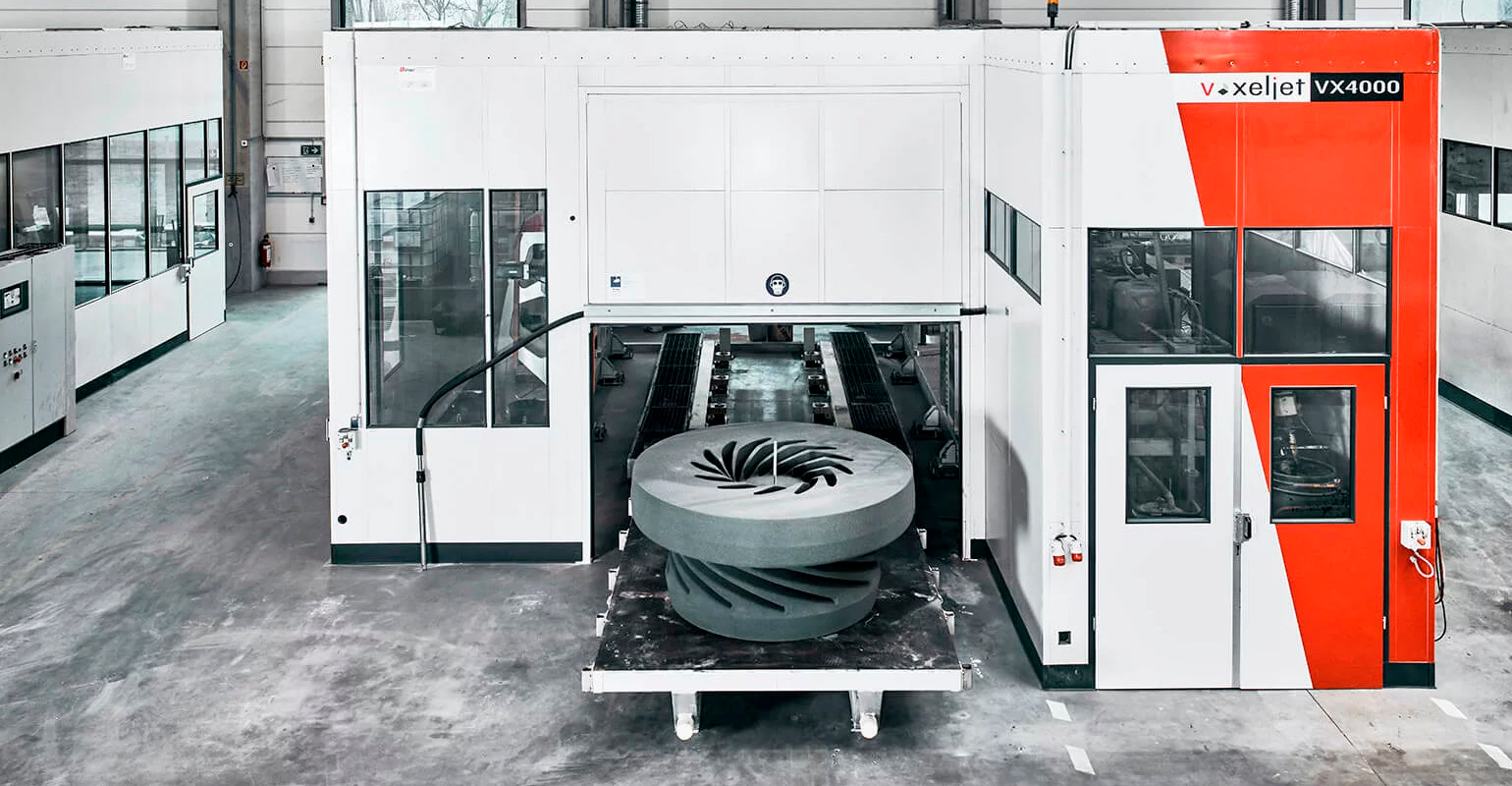

A voxeljet VX4000 large-dimension binder-jet sand printer.

GE Research selected voxeljet AG as its partner in a project to develop and commercialize large-dimension binder-jet printing of sand molds, working with a $14.9-million award from the U.S. Dept. of Energy. The DoE is backing the Advanced Casting Cell project, which is described as a step toward “clean power,” aims to produce 3D-printed sand molds for casting nacelles of the GE Haliade-X offshore wind turbine.
Earlier, in 2021, a partnership of GE Renewable Energy and voxeljet sought to develop “the world’s largest binder-jet printer for sand molds,” to streamline production of castings for the nacelles of offshore wind turbines. Such castings may weigh over 60 metric tons and measure up to 9.5 meters in diameter. That project also included Germany’s Fraunhofer Institute for Casting, Composite and Processing Technology.
