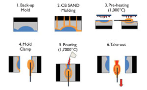

The recent improvements to the Convert Mold Process include using back-up molds to minimize material requirements, reduce cost, and shorten the time required to elevate the coated molds to 1,000°C. In addition to the process changes, a new system for pre-heating the mold cavity efficiently reduces the pre-heating cycle to three minutes or less.

Pre-heating the mold
The process of heating a mold to 1,000°C may prove to be difficult using conventional equipment. At present, most foundries use gas furnaces with high thermal capacities. In addition, the internal spaces within the mold become insulating and reduce the effectiveness of the kiln.
During commercialization a cooperative development was conducted with Tokyo Gas Engineering that resulted in a method to reduce the time required to raise the mold temperature to 1,000°C in 3 minutes or less.
Fig. 5. A gas/air or gas/oxygen mold-heating device was developed for a surface mold area of 600 x 600 mm, with a heating capacity is 400,000 cal / time.
A mold-heating device (see Fig. 5) was built for a surface mold area of 600 600 mm. The heat capacity is 400,000 cal / time. The fuel is a combination of usual gas air and gas oxygen. Heating the mold cavities in the direct, pre-heating position makes it possible to clamp the mold, simplifying the process, which results in cycle times in 3 minutes or less.
A back-up mold was used to minimize the amount of material used in the casting process. The back-up mold material uses inorganic materials, such as refractories with high heat retention like the Thermal Bonding System (TBS) of ceramic fibers developed by Japan’s Isolite Insulating Products Co. Ltd.
Cast iron is used to clamp the mold halves together for pouring.
