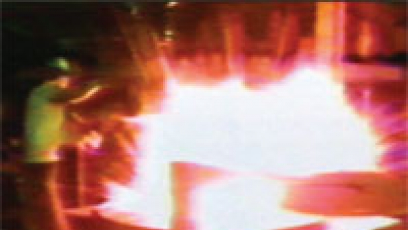

An explosion occurs when moisture is confined by molten metal.
Wet charge materials, sealed scrap, and bridging are all safety hazards that can lead to catastrophic explosions in foundries. By diligently examining and treating scrap, following induction furnace safety procedures, properly training and retraining personnel, and use of automated melt shop equipment, founders can be confident their operations are as safe as possible.
Wet charge materials are a serious safety hazard in all foundries. Water, moisture, or any liquid-bearing material instantaneously turns to steam when coming in contact with molten metal — expanding to 1,600 times its original volume and producing a violent explosion. This occurs without warning and throws molten metal and possibly high-temperature solids out of the furnace, putting workers, the furnace itself, and nearby plant and equipment at risk.
A water/molten metal explosion can occur in any type of furnace. For an induction furnace, however, the aftereffects may be more serious, including the possibility of additional explosions caused by liquid in a ruptured cooling system coming in contact with molten metal in the bath. Molten metal need not be present in the furnace for a water/molten metal explosion to occur. Explosions also can occur if sealed drums or containers containing water are charged into an empty but hot furnace. In this case, the force of the explosion will eject the newly charged material and quite likely damage the refractory lining as well.

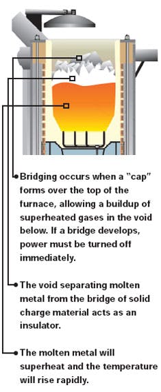

Bridging
When charge material in the top portion of the furnace is not in contact with the molten metal below it, the dangerous condition known as bridging exists. When bridging occurs, charge material is no longer serving to moderate the temperature of the bath during the melting cycle. Also, the air gap between the molten metal and the bridge acts as an insulator. The molten metal below the bridge, under the impact of full melting power, will superheat.
This superheating in an induction furnace will occur very rapidly and will raise the temperature of the molten bath above the maximum temperature rating of the refractory. Also, excessive metal stirring below the bridge, due to the small metal mass and high power density, will combine with the high metal temperatures to cause rapid lining erosion or possibly complete refractory failure.
Without immediate attention to a bridging condition, a run-out due to refractory failure may occur. If the run-out is through the bottom of the furnace, it can cause a fire under the furnace and in the pit area resulting in a loss of hydraulics, control power, and water cooling. (Be sure to keep the furnace pit area clean and dry. Do not allow water or hydraulic fluid to accumulate in the pit. It is designed to hold molten metal in case of an emergency and must be kept clean and dry.)
If the run-out is through the side of the furnace, the coil may be compromised and when cooling water comes in contact with the molten metal, the water instantaneously turns into steam. If the water becomes trapped by the molten metal, this instantaneous expansion may produce an explosion which could cause injury or death and extensive damage to equipment. Bridging can occur in any induction furnace. All furnace operators must be able to recognize bridging and its dangers and know how to solve a bridging problem.
Bridging can be minimized by using proper charge material and by making sure the different sizes of charge material are added correctly. If a bridge occurs, power must be turned off and the melt deck and surrounding areas evacuated immediately until enough time has elapsed to allow the molten metal to solidify.

Warning Signs of Bridging
Bridging may reveal itself with several warning signs. The clearest warning sign that bridging has occurred is that the melt is taking longer than calculated. Rather than increase the power, the operator should switch off power immediately. Under no circumstance should the operator increase power.
If ferrous metal is being melted, the chemical reaction which it creates on contact with the furnace lining will, under superheated conditions, produce carbon monoxide. This gas may reveal itself as small blue flames on or in the bridge. The appearance of these flames indicates the bridge may be pressurized, and it must not be breached.
In the case of a nonferrous charge, gas production will also occur, but there are no flames or other visible indications of its presence.
