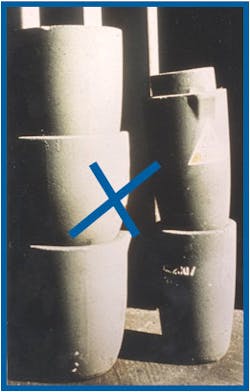

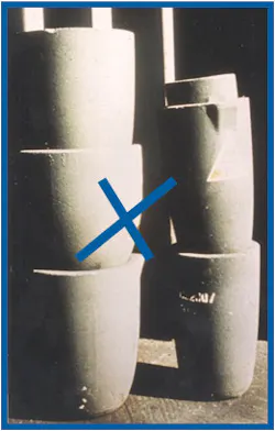

Fig. 1 – Stacking one inside the other will damage the crucibles.
Check crucible for cracks and damage when received. Be sure to handle and store it properly.  Improper handling easily damages crucibles. When a new crucible arrives, inspect it carefully for chips, cracks and abrasions and never put a damaged crucible into service. Also, when moving crucibles to a furnace or into storage, never roll them: this damages the protective glaze. And, never stack crucibles one inside the other because they will crack. Finally, never sit them directly on a concrete surface because they will absorb water on the bottom.

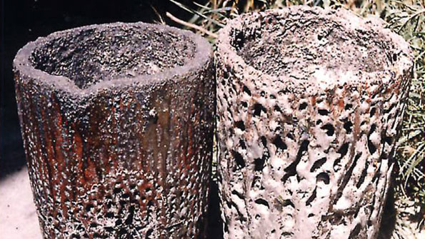

5.  Guard against chemical attack by minimizing flux usage and adding flux only after metal is fully molten. All crucibles, even those designed to resist chemical attack, can be damaged flux additives. The most effective way to minimize this damage is to add flux only after the bath is fully molten and able to dilute the material. Adding flux with the solid charge allows the concentrated flux to attack the crucible surface during the melting process. It is important also to use the minimum amount of flux that is required.
Fig. 3 – Metal with a high flux concentration was allowed to overflow these crucibles, eating away the exterior surfaces.
