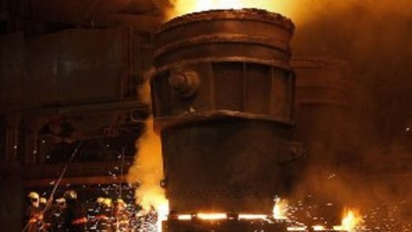

Forgemasters’ manufacturing complex at Sheffield, England, includes electric arc furnace melting and casting for ingots, foundry and forging operations, as well as large-dimension machining capabilities.
The 10,000-metric tons/year foundry pours ladles of carbon or stainless steel up 100 metric tons, for products with maximum dimensions of 16×7.6×4.6 meters. It is able to produce castings weighing up to 350 metric tons, and engineering, patternmaking, ultrasonic testing, and heat-treatment of finished products are done on site.
