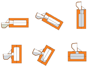

The traditional (top row, left to right: pouring, tilting, and solidification position), compared to reverse tilt-pouring (bottom row: pouring position, tilting, and solidification position.)
Aluminum permanent mold casting, or gravity die-casting, is the casting of molten aluminum in a reusable metal mold or die. The die material is most commonly cast iron or steel. Tiltpouring is one variation of the permanent mold process.
Simply put, the tilt-pour casting process is the pouring of molten aluminum into a mold by tilting the mold to fill it in a controlled fashion. In traditional tilt-pouring the mold parting line is perpendicular to the floor during the solidification phase, while in reverse tilting the parting line is parallel to the floor. Turning the parting line allows the casting to be center-fed similar to the way a casting is produced in the low-pressure process. This feature makes reverse tilting a cost-effective alternative to capital-intensive lowpressure casting. In many cases the casting can be direct poured, eliminating costly runner bars and increasing yield.
